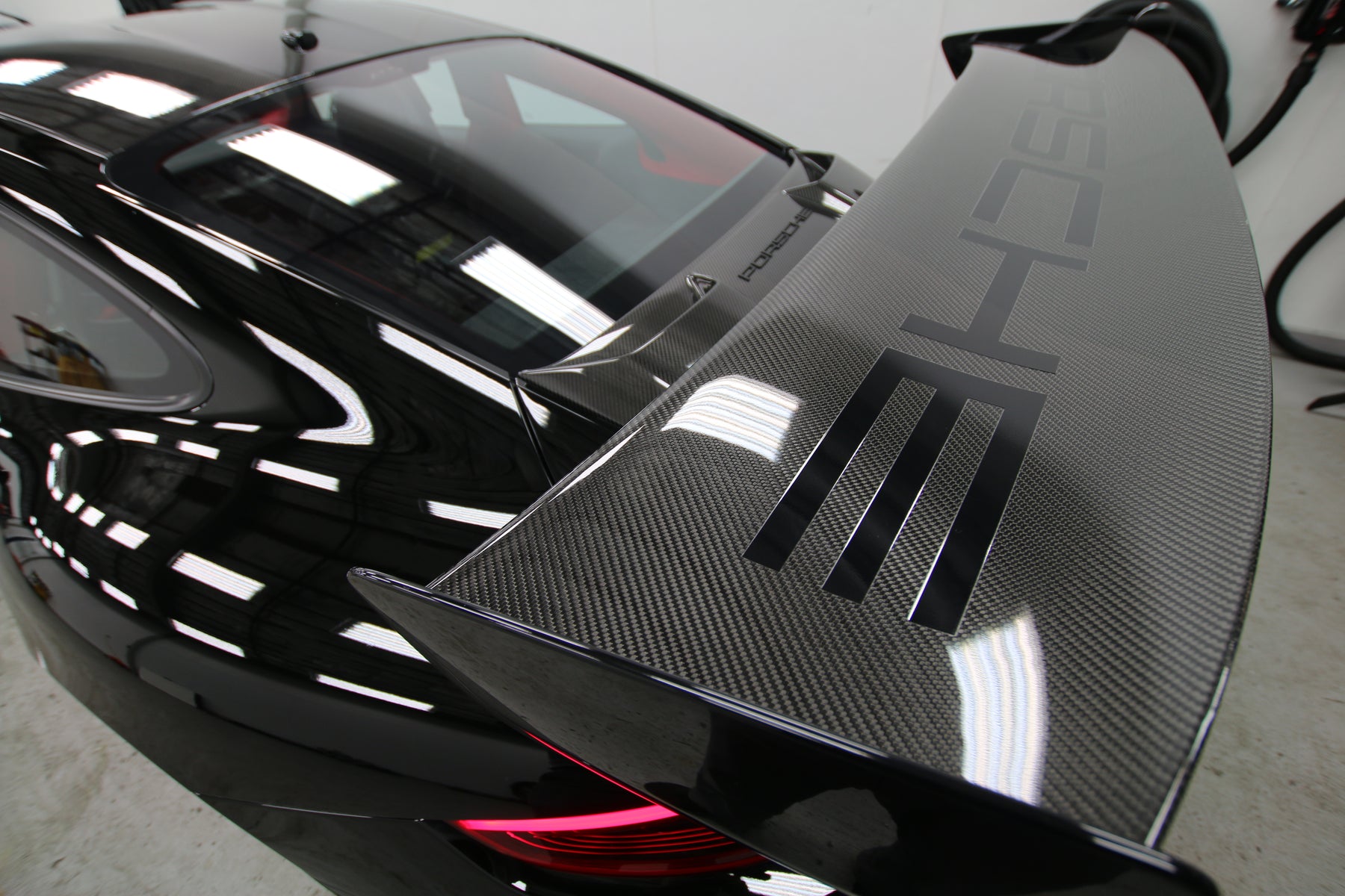

Here are a few photos of a Porsche 911 GT2RS that we just prepped for paint protection film.
Here are the defects on the hood, light scratches and scuffs, were easily taken care of with the Rupes LHR15 MKII on speed 3.5 - 4 with Rupes Keramik primed on the pad with a drop of Rupes Zehpir.
Paint defects on the Porsche 911 GT2RS Hood
Paint Defects on the Porsche 911 GT2RS
Rupes LHR15 MKII and the Rupes Blue Coarse Wool Pad
Final shot after just the only using the Rupes Coarse Wool Pad and Zephir and Keramik
